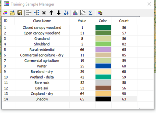

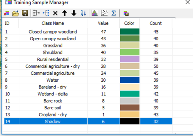

Using ArcMap 10.4.1 Interactive Supervised Classification, I have classified a Sentinel 2 image in Malawi, Africa and am trying to assess the accuracy but having issues with the confusion matrix. While I initially identified 14 classes, I understand that this is more than needed and will try to amalgamate some classes. I would first, however, like to see the per-class and overall accuracy to know how to improve the classification.
My training samples are as follows:
My testing samples are below:

I don't know how the classes listed in the confusion matrix relate to the classes I produced in the training and testing data (as there are many more classes listed than 14 and they are not labelled 1-14 as were my accuracy assessment points), and why no Producer's and User's accuracy values are shown.
If anyone has suggestions as to correcting the confusion matrix, I would be very appreciative.

I resolved the issue. The confusion matrix classes were corresponding to the "Value" column of the training sample manager and the values were (apparently) random, so I changed the values to correspond with the Class ID for both the training and testing data.
