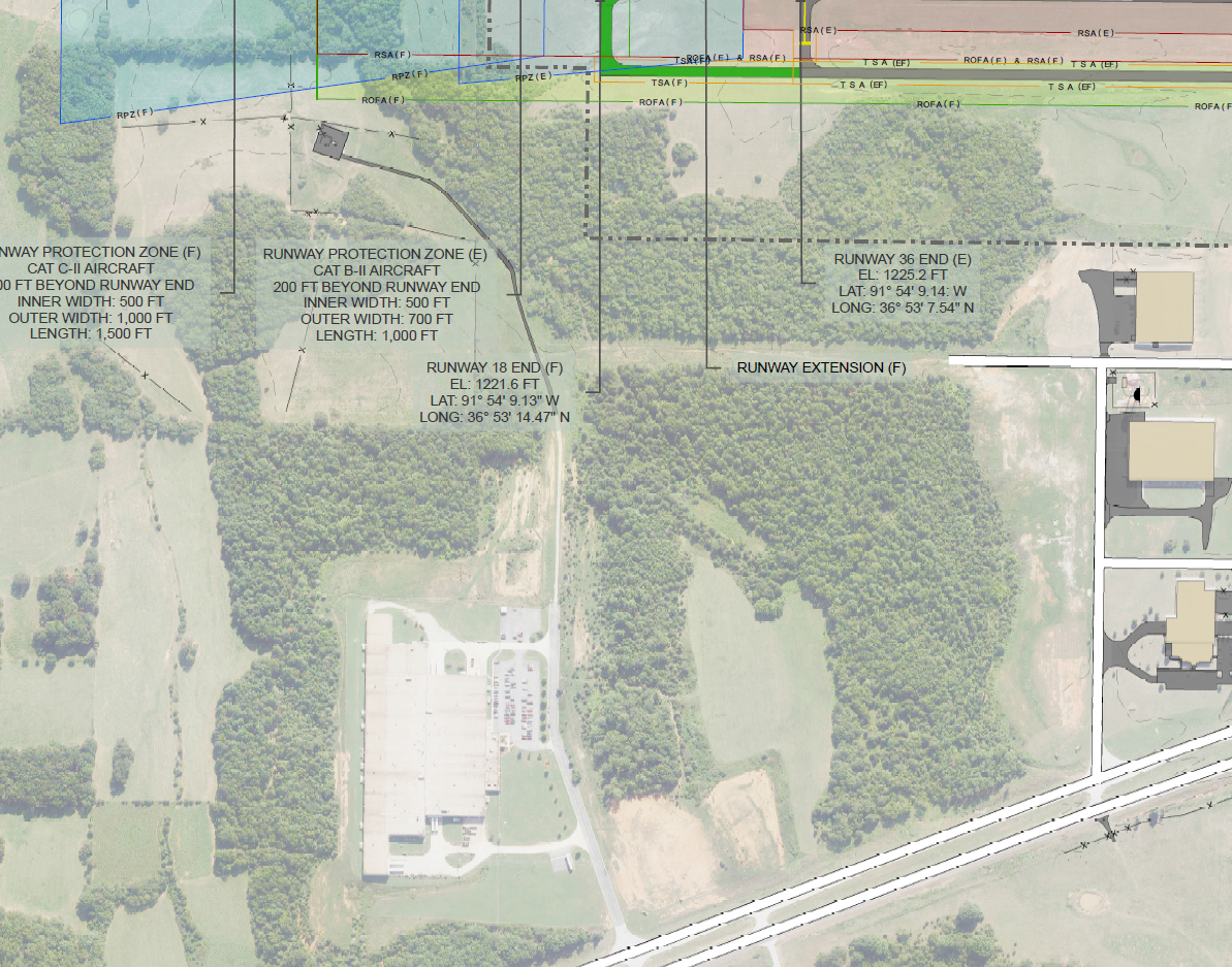

I'm having some extremely irritating issues with layers being rasterized producing really horrible lines on several map exports.  You can see a few examples of this in the image I included below.  This map contains about 15 layers of varying size, several of which are using transparency and is set to print at 34x22".  I snagged this off of a print done to .pdf at 400 dip.  I tried one at 1400dpi, and while it took forever to export, it really didn't fix anything.
I know that transparent layers can cause some issues exporting from ArcMap and I've tried a number of the fixes I've found online; including ungrouping layers, removing all unnecessary data, and moving the transparent layers as low down on the draw order as possible.  Doing this (especially changing the order of the transparent layers) has fixed most of the issues I was having, but these ugly pavement and road symbols are stubborn and still draw poorly.  The ugly grey pavement feature seen in the upper lefthand portion of the image is simply a polygon feature with dark grey outline and med grey file.  The road feature at the base is a line feature drawn as 3 lines (central while line and 2 black lines as borders) via cartographic representation.
I'm pretty sure that the root of the remaining problems the feature outline mask layer I'm using as a background for my annotations.  I've made it greenish and 50% transparent to increase the readability of the labels, but the trouble is, these transparent layers have to be up in this draw order to give much of a benefit.

  I think you have it correct that ArcMap is rasterizing all layers found under the transparency on the annotation backgrounds.  I don't know of any other method besides what you have tried.  If you could just put the anno below the pavement layers showing the aliasing effect... but then your dimension anno may not show well.
There is a remedy if you are using bmp markers/fills.  But nothing about transparency.  See the Rasterization section in Exporting your map—Help | ArcGIS Desktop
If you are able to import your mxd into ArcGIS Pro,  I understand that this is not an issue in Pro for printing and exporting.
