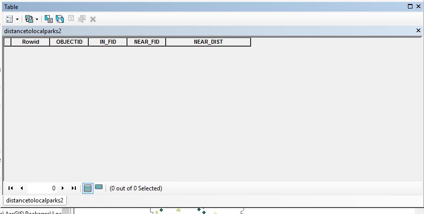

Hello all,
I have two point layers on a map. One of which is the centroid of a polygon, the other is points from a KML layer. I am trying to use the generate near table analysis tool to find the distance from these centroids to the nearest point from the KML-to-layer layer. However, every time I try and use this tool, the table generates zero results. Any suggestions on how to fix this problem?

Hi Chris,
There is no error code, it simply shows up with this.
It is on a coordinate system- WGS_GCS_1984
