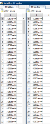

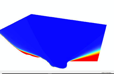

I think the issue might actually be that the netcdf file is read incorrectly. The lat and lon values in the raw data do not match the values in the displayed raster file. What could be going on here, it seems that the process to read the netcdf is straightforward and I assigned the lat/lon correctly.
DanPatterson
MVP Esteemed Contributor
They look like Eastings (X's) and Northings (Y's) to me as used by the defined coordinate system.
