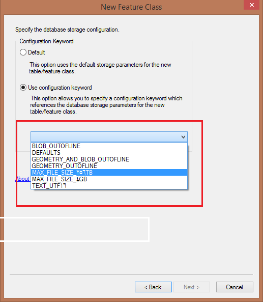

Try to create new file geodatabase and create feature class, but   make its configuration keyword to MAX_FILE_SIZE_256TB as in the following picture:
then load your data (use load data in arc catalog)  to this new feature class.
StanisławPolański
Hi Abdullah. Thank you for showing interest on my question. Sadly, your solution does not change a thing at all. 😞
