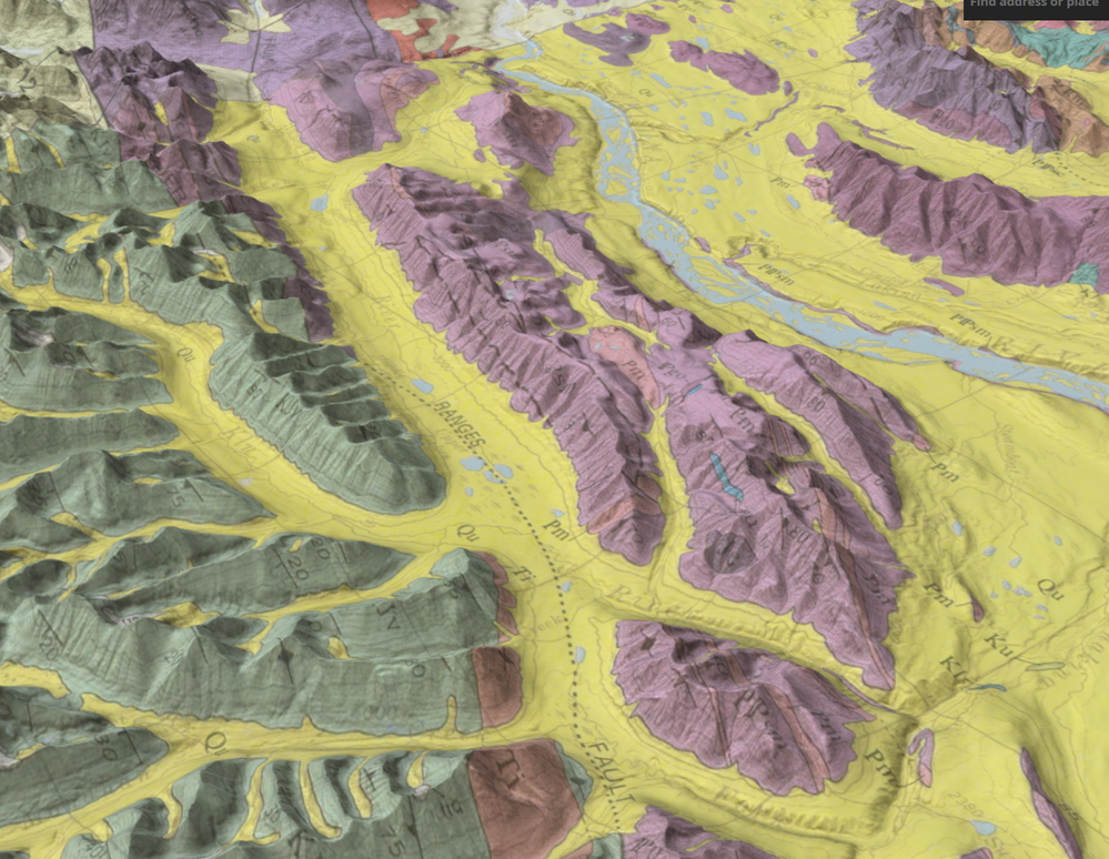

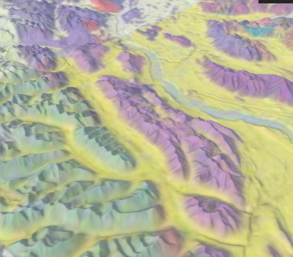

Post build 4.27, overlain cached imagery in SceneView doesn't seem to upscale as the user zooms in. It appears very low resolution. It's almost as if it's not calling the higher pyramids and simply getting stuck on the first level internal overlay. In MapView, all works as expected on the same cached services. See example SceneView screenshots from the same area in a 4.26 build vs a 4.30 build.

Thanks for the reply. This was an odd one for sure! I was calling an ImageTileLayer derived from a cached image service. In MapView, everything works as expected at all zoom levels. However, when I switched to SceneView, the same ImageTileLayer rendered what appeared to be just the first LOD. The result was a blurry overlay when zoomed in, as the LODs didn’t seem to change. This issue only occurs in builds post v.4.27. For more recent builds, I had to call TileInfo to get around this (see below). I can only assume that something changed in the way LODs are rendered for ImageTileLayer after v.4.27 (I need to look at the changelog). It may be worth looking into if others have the same issue. Cheers!
