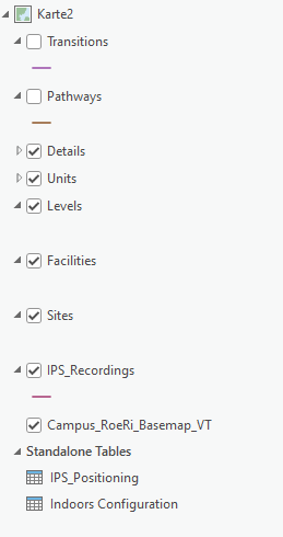

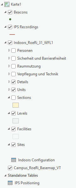

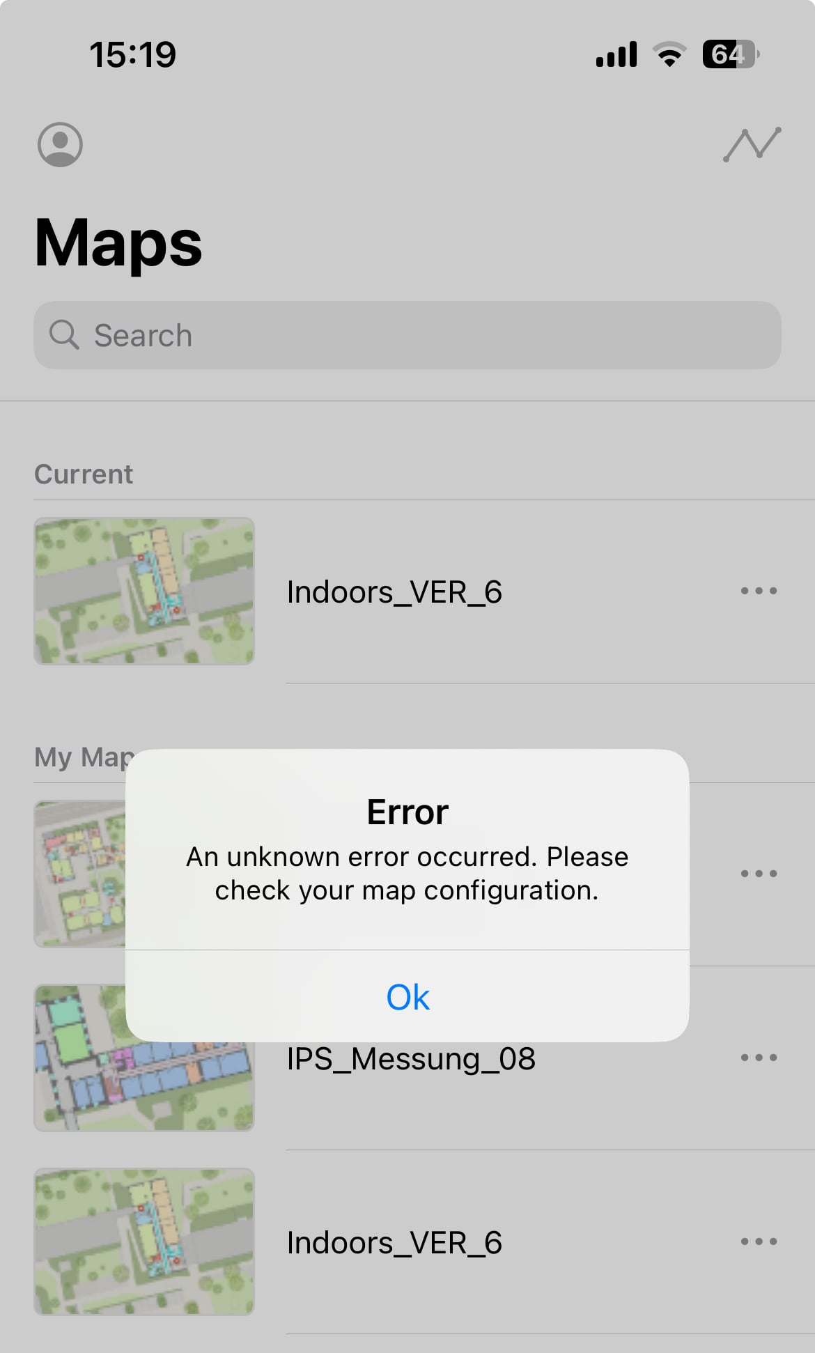

I am currently implementing an Indoor Positioning System at our University. I got the following error message when attempting to open the map in the IPS Setup application.
This has worked with this map before and suddenly does not anymore. I checked the documentation and the layer properties for the IPS Setup usage here: https://doc.arcgis.com/en/ips/latest/get-started/prepare-a-map-for-arcgis-ips.htm
The following steps have been attempted:
- Referencing the IPS Core model over Enterprise (The layers present in the WFL are IPS_Recordings feature layer and the IPS_Positioning table)
- Export the Webmap with offline Core model -> copy all data in the 'Share As Web Map' configurationScenario_02.png
- Export the IPS_Recordings and the IPS_Positioning table to the Enterprise portal and constructing the Web Map from the Portal
As I can see, all required fields are there,
I am sure it is a little oversight on my part but I am quite clueless at the exact moment. If further information is required, I will be able to provide it.
If anybody has a troubleshooting line, this would be greatly appreciated. Thank you in Advance!

AntoineFeike
Hello,
that's indeed a mistake made, and it is corrected. The shared feature layer within the map is now editable.
Unfortunately, this did not solve the issue and it still tells me to check the map configuration. I also cannot give you access to the map as the service runs on a closed Enterprise server.
I just tried removing the underscores in the IPS_Recordings and the IPS_Positioning layer name. This also resulted in no mitigation of the error.
At this time, almost every thinkable option was exhausted.
To be sure I tried deleting the IPS Setup application and reinstalling it on an iPhone 13. This resulted in the solution! I think, the app cached some data and blocked the usage of the map.
Thank you for your help and I wish you all the best!
