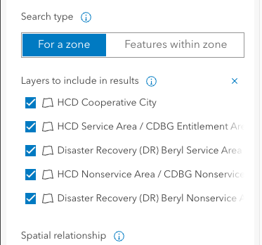

I took a look at the way your app is configured and it looks like all five layers are included in the "Layers to include in results" section. If you remove the layers you don't want included does that return the proper results?
