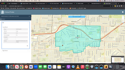

LeviCecil
Hey, I finally got to this. I duplicated the layer, but I still have the same issue.
KellyHutchins
Esri Notable Contributor
Is it working as expected in the test app I linked above? If so can you compare the settings in your app to the ones in mine.
My Demo App
https://www.arcgis.com/sharing/rest/content/items/65d52b1bf18d4c42a68137617d3062fa/data?f=json
Your app settings:
:https://pdxschools.maps.arcgis.com/sharing/rest/content/items/7b665b666982448b86985e4a3cd1a11a/data?...
LeviCecil
Yes, it's working in your example. The only difference I'm seeing is in the preset layer effects.
KellyHutchins
In your app it looks like showing popups for layers not in the results is turned off. If you turn this on I think you'll get what you need after the Online release in a few weeks.
You can find the setting in Zone Lookup > "Enable pop-up for layers not included in results"
