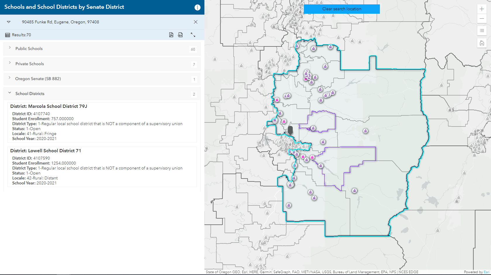

I am trying to configure a Zone Lookup app using the "Features within zone" option. I've selected a polygon layer to use as the search zone and some point and polygon layers to include in the results.
I've noticed that only polygons that are fully within the search polygon are returned:
Is there a way to return any polygons that intersect with the search polygon?

Currently - as you've discovered - it only returns features that are contained within the search polygon. Adding support for the app to be configured to support either intersects or contains is on our roadmap and should be available as a configuration option at the next release.

Thanks @KellyHutchins! Super excited to hear it is in the roadmap, potentially as soon as next release!
