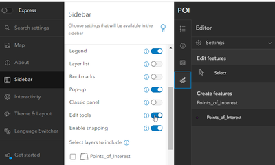

I'm working in ArcGIS Enterprise 11.3 with a Sidebar instant app.
I created a web map and set up the editing forms along with a related table. Editing works fine in the web map.
When I add the map to a Sidebar instant app, no editing icon appears.
How do I get the app to recognise that the layers are editable?
Thanks
Hanlie
ChryseMorales
Hi Hanlie,
When you configure the template, in the 'Sidebar' tab that appears when you turn off express mode, there should be a toggle you can enable for the edit tools. Let us know if you have any issues with that, thanks for reaching out!
ChryseMorales
Hi Hanlie,
HanliePetoors
Thanks @chrichris I got the editing going.
