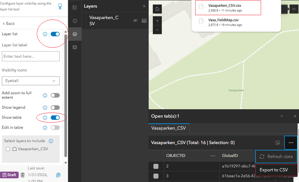

No, it is not broken,  just kindly turn off Express Mode to access the full configuration settings. ArcGIS Instant Apps uses Express Mode by default, which provides a step-by-step guided configuration and is primarily designed for rapid app creation.
In the configuration settings, enable Layer List and Show Table. Once enabled, you can easily open the table and export it to a CSV file, as shown below. I hope this helps a bit.
Best,
Faiez

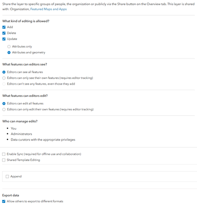

I also tried with a creator > admin privileges and also viewer, data editor privileges. In the hosted feature layer settings, I have these enabled:
When I click export to CSV, a single point briefly gets highlighted in yellow, but no downloads start.

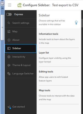

Could you take full-page screenshots, one for the Sidebar tab and another for Interactivity tab?

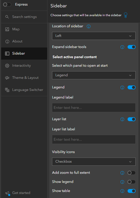

ArcGIS Instant Apps are continuously updated by Esri developers and don’t use formal version numbers. Updates roll out alongside ArcGIS Online, while Enterprise updates are managed by each organization. The latest changes, from October 2025, include new templates, improved configuration, and alignment with current web mapping standards. You can clearly see the difference between my sidebar an yours,  as yours appears to be from 2022 while mine reflects the updated interface.
 Updated: October 2025 ,This is the one I'm using.
Updated: 2022 ,This is the one you are using

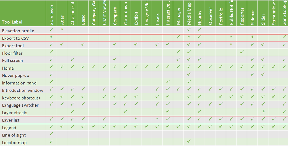

I knew you already knew it, no doubt at all. I just believe people learn best by sharing thoughts and ideas. It looks like the full screenshot wasn’t shared, is not it?😊
Just sharing the below screenshot in case it helps, there’s some useful information about ArcGIS Instant Apps and the Template Capabilities Matrix with ArcGIS Enterprise 11.5.
ArcGIS Instant Apps Matrix ArcGIS Enterprise 11.5.pngArcGIS Instant Apps Matrix ArcGIS Enterprise 11.5.png
I'm also sharing a very helpful link about Instant Apps, highlighting the Sidebar template updates introduced in June 2022 ArcGIS Online release, very useful for anyone exploring ArcGIS Instant Apps.

Please see the following screenshots.
Faiez
Thanks for the sidebars screenshots.
