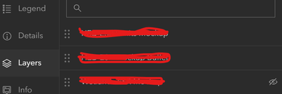

Table is available in Sidebar via the Layer list configuration. Once you've enabled the layer list you can choose layers from the dropdown then enable add table.
The current process can be a little confusing so in the upcoming release of Online you'll no longer need to select a layer you just choose to enable tables for layers in the layer list
