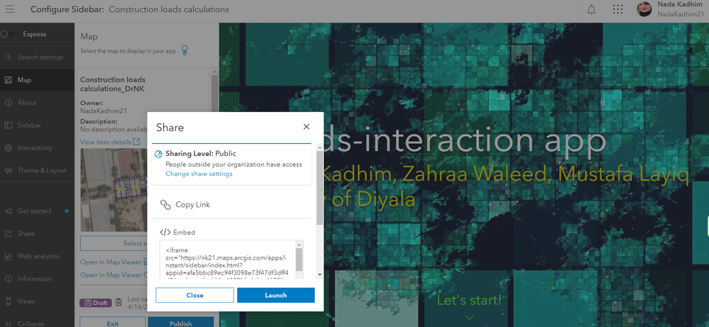

I just would like to ask about the option of sharing publicly of my instant app. This is the first time I use the instant app and when I finished my app I chose this option: sharing level: public.
My question is about people outside my organization if they want to use it, should they have an ArcGIS Online account to access my ArcGIS Instant App or they can access it directly without any registration or having Esri account? Because I want people to use this app without restrictions such as they should have an account to allow them to use my app.

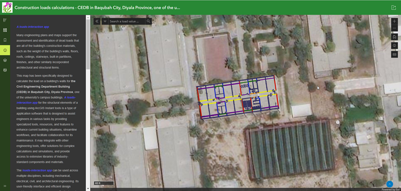

Thanks for adding the screen capture, it really helped me figure this out for you, I can see that you are trying to use the Sidebar Instant App.
The link that you sent me is the link that you see when you are configuring the Instant App. You likely captured it from the URL you saw in your browser while you were working with configuring the Instant App.  I won't be able to open that link and that is not the link you want to use.

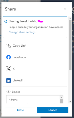

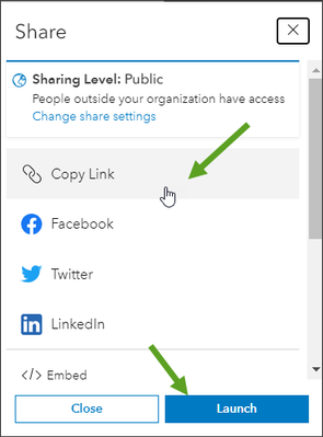

The link you need to use is the one generated via the Copy Link option or the link you see after you click Launch. Both Copy Link and Launch will return links that you can share with others that will allow public access to your app.

Both of these work perfectly, and I was able to see your app, the intro panel, and advance beyond the intro. Here's the proof:
Hopefully this will make sense and get you started along your Instant Apps way. You can prove this works by using the Copy Link or Launch URL in an incognito window.

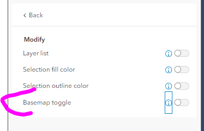

YES!! That was it. It's a Bing Basemap Aerial Hybrid that wasn't shared publicly. I updated the sharing and now it's working. It's odd because we have allowed the Bing Maps key to be used in our public maps.

The only difference between the 2 links is that I didn't configure the Basemap Toggle option in the app that worked. It's weird that when changing the sharing level of the app to public I wasn't given the alert saying that this basemap layer wasn't shared the same, like the Instant app treats 'layers' different from 'Basemap-layers', or something.
Also, we use that same Bing basemap item in other Web apps shared publicly without issue. So, I'm curious if it's a specific behavior of the Instant Apps??
