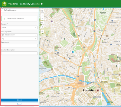

@LinzMess Yes, this is possible. The fields that can be edited in the Reporter Instant App are based off the edit form you create in the map viewer (help topic for steps on setting this up). You will also need to configure the popup in the Map Viewer, that is what will be shown in the side panel when a user views other reports. Below is a screenshot of how the edit form is exposed in Reporter.
This is where the pop-up of a feature is shown in the Reporter app.
