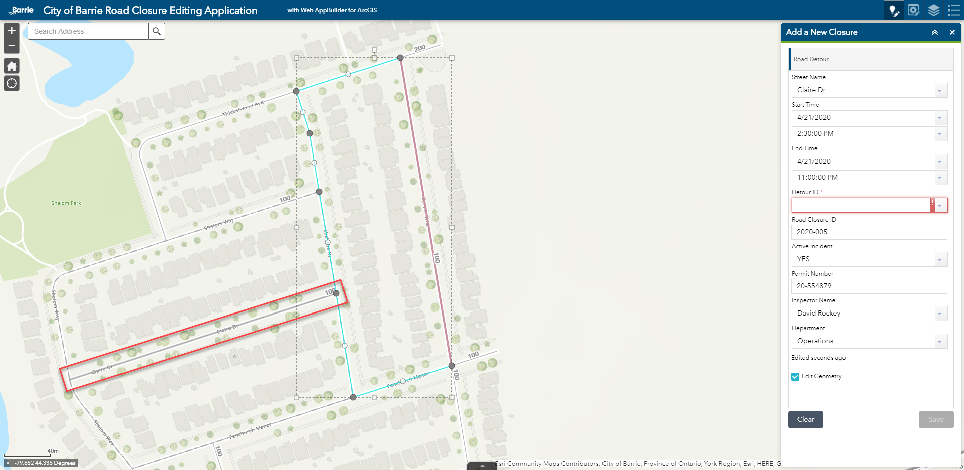

I am creating a web application using WebAppBuilder through ArcGIS Enterprise, and am trying to leverage the Attribute Actions through the Smart Editor widget. I'd like for the user to be able to draw in a road detour, and based off the buffer set in the Attribute Actions, auto-populate the fields from the intersected road closure.
However, when I draw in the detour route, it pulls the information from an inactive closure (highlighted in red), which is not the information that goes with the associated detour (we would like the information from the pink road closure).

Can you filter out the inactive closure so the new detour does not overlap it?
BrittanyZucchetto
I have my inactive status set through an arcade expression, so I cannot filter based on the expression. I have the inactive layer turned off for symbology, but it still pulls that data when I draw the new line.
RickeyFight
MVP Alum
Brittany Zucchetto
Can you filter out the one that is giving you an issue with using another field and see if it works.
BrittanyZucchetto
I've tried filtering based on the end date to now show any closures which end before today. It still pulled the record for the inactive feature.
