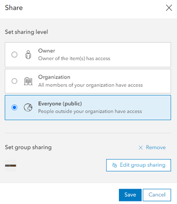

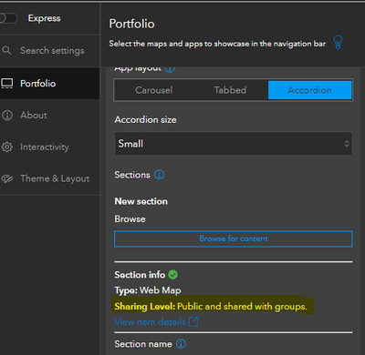

Map sharing level from Portfolio:
Sharing level per map info:
