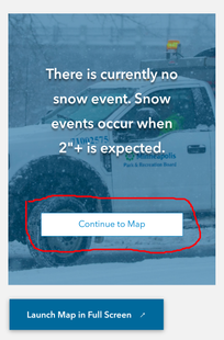

We have a cover page with a button to continue.  It works great on a desktop, but when on an iPhone or Android it does not work.  Any ideas or suggestions?

Thanks for the link. We were able to reproduce the issue and will working on getting a fix out for this. In the meantime if you disable the "Open legend at start" option until the fix goes out you should be able to close the cover page on mobile devices.
Once the fix goes in you can re-enable that setting

I've tested with a sample app and can't reproduce on an iphone. Is your app public? If so can you share it?  Here is the test app which is working for me. https://jsapi.maps.arcgis.com/apps/instant/media/index.html?appid=3205e45f82c64dbd8bb704f82b4f7891
