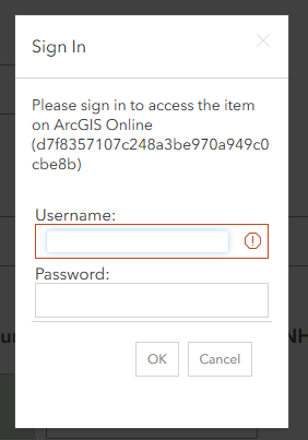

I want to use Survey 123 to share a Survey with the general public. Can I set it up so that users do not need an ArcGIS account to log in?
1486
03-30-2020 11:29 AM
Paul_E
I set up a survey, posted and shared it. Potential users see this screen when they go to the web site.
I find it very suspicious that in Survey123 the "Members of my organization" box is grayed out.
1) Maybe it doesn't matter,
2) maybe my account is not set up to allow me to share things publicly, or
3) maybe Survey123 is designed so that anyone can contribute, but only if they have an ArcGIS account.
Which is it?

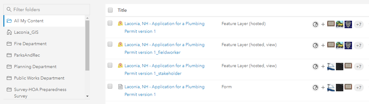

Hi Paul Elsholz‌, is the hosted feature layer that the survey writes to shared publicly? I can not find that Item ID in ArcGIS Online
Paul_E
As far as I can tell it is.

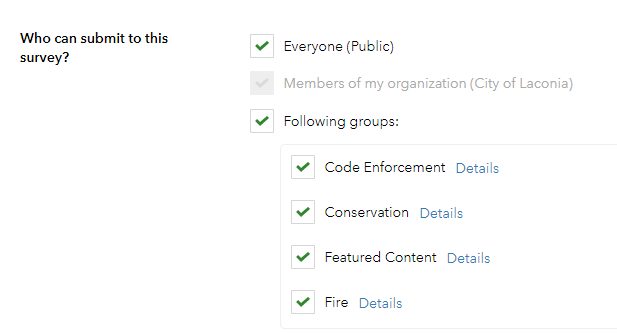

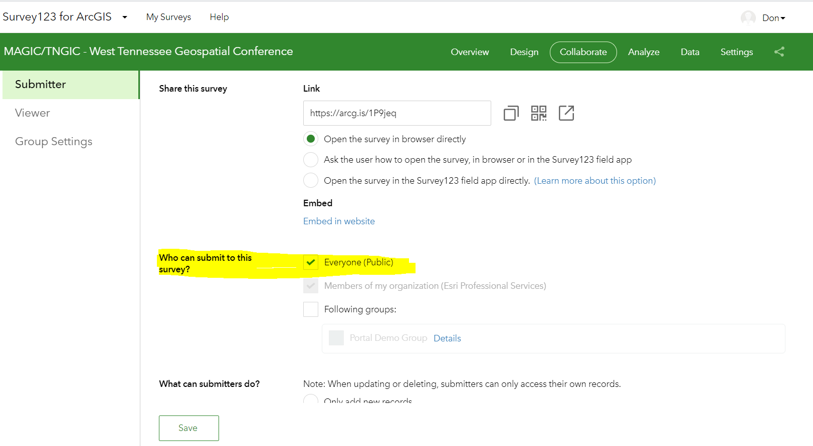

Can you confirm the following setting under Collaborate > Submitter?
Paul_E
Yes. I took a screenshot of that setting (zoomed in) and posted it with the original question.
