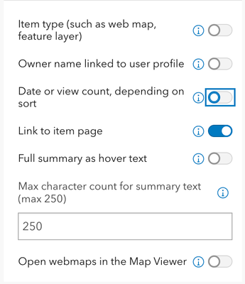

Thanks for the feedback. If you toggle off the Express option at the top of the config panel you'll see that there are options to disable the author, item type, date, view count etc.  There isn't a config option for disabling the summary but we can look into that for a future release.  
Screen Shot 2022-07-27 at 8.44.11 AM.pngScreen Shot 2022-07-27 at 8.44.11 AM.png
However you can turn off the summary using the Custom CSS option that can be found in the Theme and Layout section of the config panel. If you paste this css into the input box it will hide the summary and make the item cards a bit smaller:
.card-gc__snippet{display:none;} .card-gc__details-container{min-height:200px;}

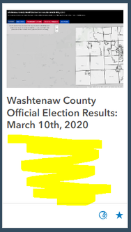

This thread has been really helpful. Is there a way to completely remove the icons at the bottom of the cards? I'm currently seeing the authoritative badge & the app launch icon (which is unnecessary because the thumbnail launches the app) & I'd like to not have these or the extra space at the bottom of the card.  Attaching image. Thanks!
KellyHutchins
Esri Notable Contributor
You should be able to hide that using this custom css:
.card-gc__sub-container{
display:none;}
