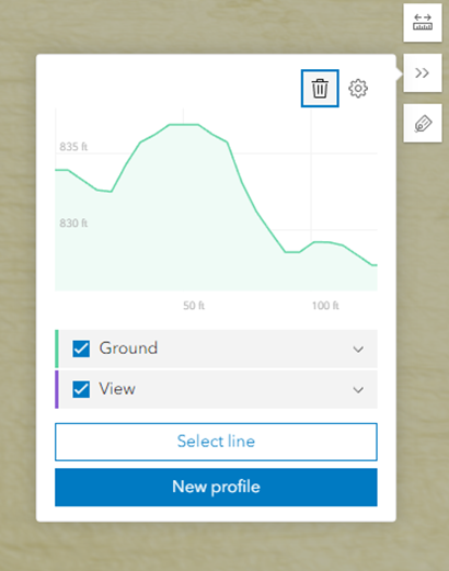

The width of the elevation profile widget window is much narrower than it was before the last ArcGIS Online update in instant apps 3D viewer.  The widget has lost much of its value for analyzing surfaces with the new width.
Prior to update:
After Update:
Can the widget window width be restored to the wide setting?

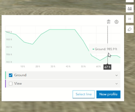

You can use the custom CSS option in the app configuration to make the elevation profile window wider. To do this configure the app and navigate to Theme & Layout > Theme then find the Custom CSS  and use the edit option to add this css to the app.
.profile-container , .esri-elevation-profile.esri-widget.esri-widget--panel{
width:60vw;
In the example above we use viewport units (vw) which will set the elevation profile panel to be 60% of the viewport (browser window) width. You can modify that number to fit your needs.  Here's an example of how it looks in action

BruceRiesterer
Thanks Kelly!  The Custom CSS code works great.   Now I 'm trying to find the correct code to position the panel at the bottom-right of the screen.
