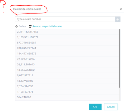

Hello and good morning All,
I am wondering if I can 'customize the visible scales' in Instant Apps, the way it could be done in Web App builder ??  I am creating an Instant app for public consumption and want to limit how close in someone can zoom.
Here is a pic of how the customizable scales dialog looked in  Web app builder:
Thanks !!
Jarrett

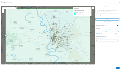

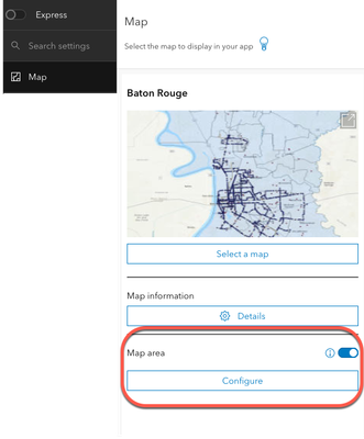

SarahMcDonald_Esri
Hi @JarrettLivesey1
This can typically be done with the navigation boundary tool in the map area component. https://doc.arcgis.com/en/instant-apps/latest/customize/content-settings.htm#:~:text=Most%20apps%20i...
The map area component is available in most of the Instant Apps. The map area component is listed in the map section, once it's enabled you can configure the navigation boundary.
Thanks!
Sarah
