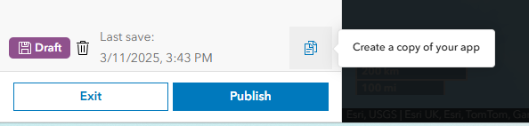

Hi all,
I have an app using the Atlas Instant App template. I have it configured to how I want it to look and work, and it is set to use the content from a group. I want to create multiple versions of this app that look and work the same but use content from different groups. I thought I could duplicate the app using the Copy option:
However this just created a brand new app with nothing configured like the original, it is reverted back to the default of the Atlas template. When I try to configure the copy, I get stuck on the loading screen. Is this a bug? And does the copy option create app duplicates?

AMatthews
Hi @MikeVolz, thanks for the suggestion. I used the AGOL Assistant Copy Item option and it worked perfectly, I now have a duplicate of my app. If anyone else is looking to copy an app this may be the way to go.
BethRomero
@AMatthews can you share what Instant Apps template you were trying to copy? It should copy an exact duplicate of what you have configured.
AMatthews
@BethRomero it is the Atlas Instant App template, I just gave the copy button another go and it created a copy of the app, but did not bring over any of the settings I have configured for it, it just created a blank Atlas template app. I managed to use the AGOL Assistant to create an exact duplicate of my app, which is a good workaround for now, but perhaps the copy issue could be something the Esri team look into? Thanks
