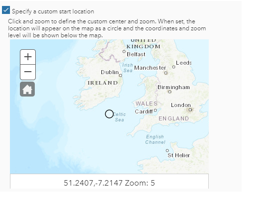

Yes, you can set a custom start location in Layer Showcase.  While configuring the app, navigate to General tab, scroll to the bottom and check on Specify a custom start location.  This allows you to change the start extent for the app.
