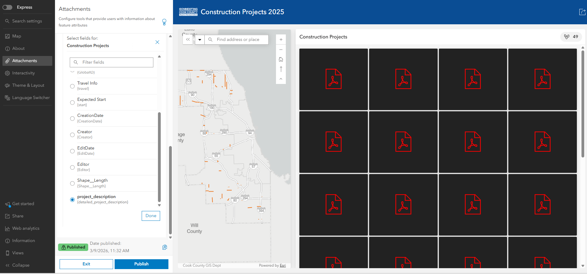

The instant app has an option for accessibility in the attachments section. The tool let's me select a field as the input however it does not use display the field text, it defaults to the table name. See the images below as references.

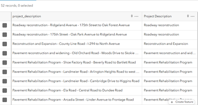

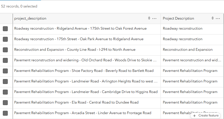

table example:
instant app selection

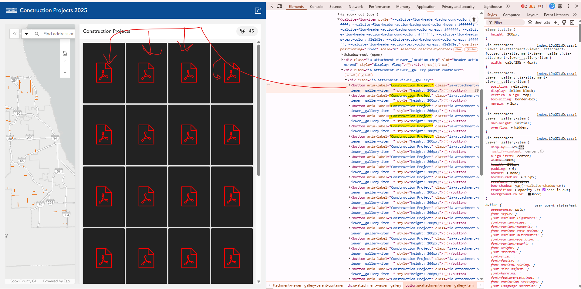

 Label issue, aria label showing the table name and not the field user selected.

For the issue you reported, I had a chance to look into this more. In one of the screenshots shared above the developer tools are pointing to the aria-label. That is not actually the alt text that the attachments alternative text is referring to. The aria label is actually using the pop-up title which is why you are seeing "Construction project" for each aria-label.
The Aria-label is slightly different than alternative text. Alt text describes visual content or the purpose of an image. Aria-labels provide an accessible name for interactive elements.
