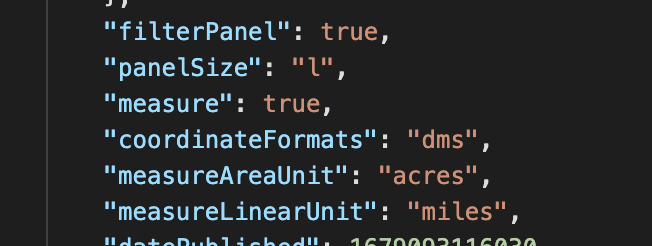

@CoreyMetz we do have plans to add support for linear and area units at the next release. In the meantime if you are comfortable using a tool like AGO Assistant you can update the app data to set these values now. I recommend making a copy of your app first and testing out the steps there before editing your app. Here are the basic steps:
1. Open AGO assistant and log-in to your org
2. Navigate to your content and find the Sidebar app you want to edit
3. Click the app title then click the "View Item JSON" button
4. In the Edit JSON panel click the Data tab then click the "Edit JSON" button
5. Look for measure:true then add the following options to set the linear and area units.
6. Save and test your app.
Valid values for area and length units can be found in the SDK reference: https://developers.arcgis.com/javascript/latest/api-reference/esri-core-units.html#AreaUnit

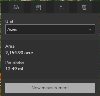

Question though - I have my linear unit set to "feet" and my area unit set to "acres", but when the tool is used in the app while the area is reported in acres the perimeter of the shape is still reported in miles.  Any way to change that to "feet" as well?
