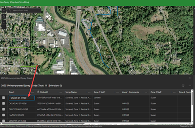

@SarahMcDonald_Esri I am testing editing in the table.
In map viewer I set the road name to be read only.
In the sidebar app table, it is allowing me to edit the road name.
Should I be configuring which fields are editable and which are view only in another location? Or is this possibly a bug?
As a side note, the edit widget is not allowing me to edit the road name in the pop-up window, so that tool is working correctly:
SarahMcDonald_Esri
Hi @L77
Thanks for reaching out about this. The smart form that is configured in map viewer will only apply "Read only" to fields where the smart form is used - in the edit tool.
Editing in the table will not apply that read only setting from the smart form. Instead, if you go to the feature layer data tab in the item details page you can set read only on the fields there. The read only setting will be applied anywhere that layer can be edited.
Thanks!
Sarah
L77
It worked, thank you!
