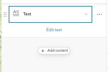

@JAVT  how are you removing all content from the popup. If I go into the map viewer and remove the content from the popup then save the map, close it and reopen it the popup defaults to the list of fields.
But if I add a text element, edit the text and just add a space then save it seems to respect that and will display the empty popup content in the Sidebar app.

Here's an example:

JAVT
Adding a blank text element is a good work around . Thanks!
