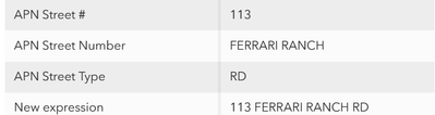

Allow the beta public notification tool to use Arcade Expressions within the downloads. I noticed it works fine with default fields. However, when I create custom expression using Arcade, the pdf and csv downloads no longer work. The end goal with using arcade in this app is 1) concatenate fields (St#, St Name, Apt...) and 2) Remove the null fields from being visible in the pdf export. If an address field is parsed out and it has no apartment/unit number, the app automatically puts "null" in the mailing pdf.
This should currently work in the Public Notification app. Can you share the arcade expression you are using and a screenshot of the popup - include the HTML view? Or share the link to the webmap or app if they are public.
Hello Kelly. I Appreciate the quick response.
This is my Arcade Expression: $feature.STREETNUM+ " "+ $feature.STREETDIR+" "+$feature.STREETNAME+" "+$feature.STREETTYPE+" "+$feature["SP_APT"]
The New expression is a concatenation of the individual address fields. Unfortunately, I cannot share the web map as it contains PII.
I tested in chrome and firefox with the same result. I can't download the .csv or .pdf until I remove the expression from the pop-up. I don't have to delete it, just remove it.
