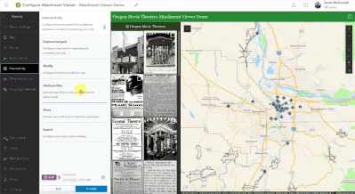

Hi @DfIRivers
Thanks for reaching out about this. The attribute filter tool is available in Attachment Viewer. Using the attribute filter tool, you can set up different types of filters like a date filter.
Thanks!
Sarah
