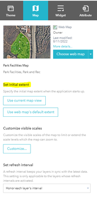

I would love to be able to easily and quickly Set initial extent in an Instant app like we could in webapp classic.

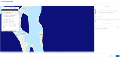

We added a similar component into the Slider template in the most recent ArcGIS Online Update. We call it the Map area component. We are planning to add this to additional templates in future releases.
If you have a minute to check out the Map area component in the Slider template, you will see see that it is able to complete the same functions as the "Set initial extent" tool from Web Appbuilder. Let me know if you have any questions.

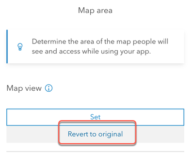

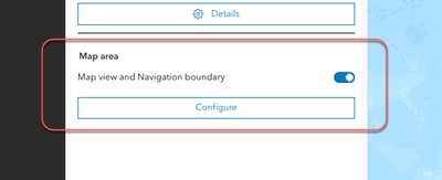

In Slider, when the app is first created the web maps default extent will be used, the default will only change if you specify it in the map area component. If you want to reset the default map extent to the web maps extent you can turn off the map area tool in the app configuration or in the map area component use the 'revert to original' button.
In the map area component,  we do offer the search tool that can be used to search for places. Using that tool you. could search for a political boundary like a city, town, state then set that as the default extent.  However, we are keeping in mind the potential use case of using a layer in the map as an extent.
For the navigation boundary, it will constrain search results. So no results/suggestions in the search tool will be returned that are outside of the boundary that is set up.
