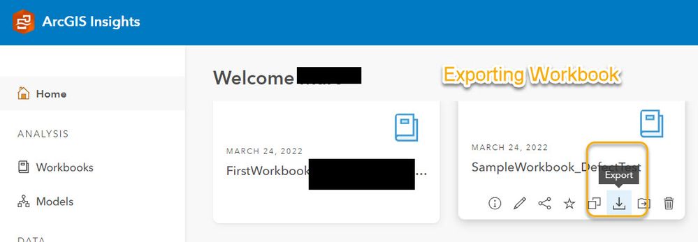

    • Reviewing the Export option under Insights> Home > [WorkbookName] > and selecting Export under the three ellipses optionReviewing the Export option under Insights> Home > [WorkbookName] > and selecting Export under the three ellipses option

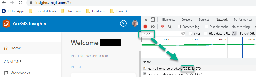

      • ArcGIS Online- This will always be the latest version, which you can confirm by reviewing network traffic, open the Insights homepage and filter network traffic results for the suspected base version; e.g.:
        Reviewing network traffic in web browser and searching for term '2022' to confirm that we are using the latest base version of Insights in ArcGIS OnlineReviewing network traffic in web browser and searching for term '2022' to confirm that we are using the latest base version of Insights in ArcGIS Online
