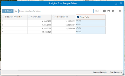

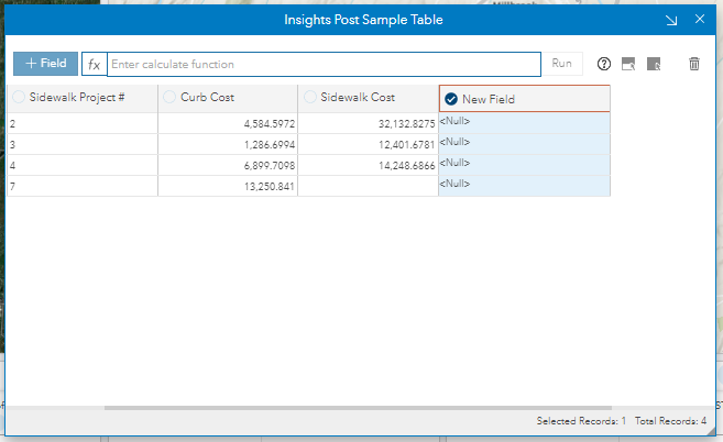

I created a table from the "Create Relationships" functionality using the "Full" relationship type.  I am trying to generate a New Field that replaces any Null/No Value/Blank rows with a zero, while preserving the other non-null or non-no-values from a particular column.
I know we can test for these values using the fxISNULL or fxISNOTNULL, but I am having difficulty leveraging this to populate/replace no values/nulls/blank.
Any advice or solutions for this?

@AndrewKinlock If you would like to use ISNULL or ISNOTNULL you can choose to do something like IF(ISNULL(<Field>), "Text",<Field>). ISNULL(FIELD) will return "True" Or "False" for the sake of the IF function or 0/1 without it.
It makes sense to create a new Calc field in the analysis if you would like to support scheduled refresh. The Data Engineering is not yet at a stage where it can be scheduled to refresh. Though will be under consideration if/when DE makes it to ArcGIS Enterprise.

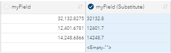

I was though able to switch myField from a Number to a String and used this function in Insights Online: SUBSTITUTE(myField,"","0")
The output from that function substitutes the blank row as: <Empty-">
Was the correct Insights function used properly?

I believe it is the correct function! 🙂
This should work, in my opinion, if <Empty> is an okay result for your situation. However, I must admit, there will be people far more expert at this on here than myself, so they may have additional solutions. (I'm a bona fide hack when it comes to writing efficient functions.)
