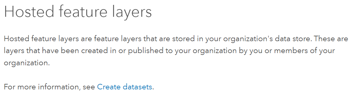

Hello,
This is the definition of Insights hosted feature layers from https://doc.arcgis.com/en/insights/latest/get-started/feature-layers.htm.
I was hoping that "Insights hosted feature layers" would include ArcGIS Enterprise feature layers that are on MS SQL Server in an Enterprise Geodatabase registered as a data store, but my testing has shown otherwise.  They show as "Remote feature layers".  The vast majority of our data will reside on the MS SQL Enterprise Geodatabase severely restricting Insights functionality.
That is unless, I'm missing something.  Is it possible for data residing on an Enterprise Geodatabase to NOT be remote?
Let me know.
