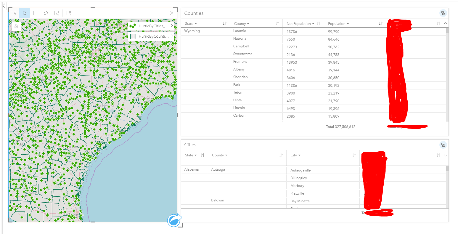

Hello,
I am trying to figure out how to filter the cards from different datasets with one selection on the map containing the layers underlying the cards.
The map contains 2 layers (one with polygons and one with points): 1 layer for upper card and 1 layer for lower card. I can do the selection on the map with lasso, but it will filter only one of the cards, depending on which layer is active on the map. No matter what I try with spatial, predefined filters, nothing works to make both cards being filtered by a single selection on the map.
Any help is appreciated.
Thank you,
Yulia
Scott_atEsri
Hi Yulia,
In order for selections and filters to work across multiple different cards, it must be reading the same dataset.  If the data is currently residing in two separate datasets, you can bring it together by using create relationships.  This will support both traditional joins, as well as spatial joins.  Once it's the same dataset, you should be able to have the interactivity across cards.
Create relationships to join datasets—Insights Get Started | Documentation
