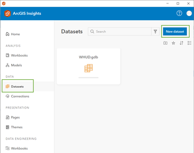

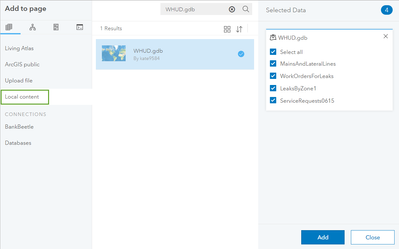

KateMaclachlan
Hi Saadullah,
In order to upload a .gdb file you must do this from the datasets tab on the Homepage. You cannot upload .gdb(even if its zipped) in the Add to page dialogue within the workbook at this time - hopefully in the future!
Once you have uploaded the dataset into the homepage it will appear in your Add to page dialogue under "Local content"
Hopefully this helps!
Kate

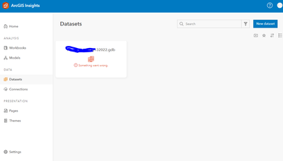

Nope, it also fails to upload this way.

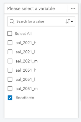

I will add though if Insights supported multiple column/variable selection in a single drop down menu, that would drastically reduce the data size. Because right now, in order to have such a selection, I have to pivot long the dataset which increases the number of rows by multiple folds thus increasing the data size.
