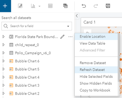

does it help if you refresh data?
FrancisGagne1
I cannot open any Workspace.
