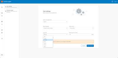

Sorry for the delayed response. Log files can found at these locations:
Windows    C:\Users\<username>\AppData\Roaming\Esri\ArcGIS Insights\logs
Mac    /Users/<username>/Library/Application Support/Esri/ArcGIS Insights/logs
You may need to change your log level to Debug and try the operation again.

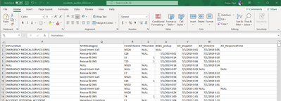

I have a .xlsx with 394039 rows and columns up to AT (about 175 MB).  It has a lot of date fields.  Here is a snip...

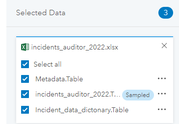

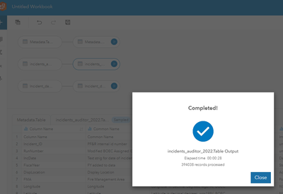

Interestingly I tried running this on a different computer before updating and it worked, so I'm assuming it was something with the local install.  And I just tried it in a new workbook and it works.  So I'm guessing there was some crud left over from the previous attempt, which was done under the previous version.  Also I see there are two additional tables to import for metadata and data dictionary.  So thank you for the improvements and I'll let you know if I get stuck again.
