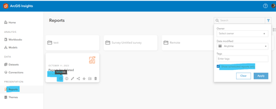

@CalebK  Only shared reports can be scheduled to refresh and not the workbooks. You can find if you have scheduled reports by going to the reports tab on the home page and filtering on the scheduled page. Failed scheduled reports can leave behind a blank workbook as it creates a temp workbook to store new analysis until the update is successful.
If you are actively seeing blank workbooks appear in your workbook tab, you want to check the active scheduled reports (not paused). I recommend you open those reports and check if they have any errors e.g dataset no longer available or cards in an error state etc.  Then check the reports that were scheduled but are now paused in the same way.

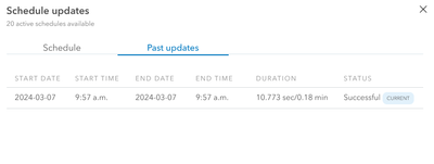

Also, see if you have any past updates by clicking the schedule icon on the card and switching to past updates: (Note: This information is retained for a certain # of days)

When I switch to the reports tab under presentations, I only see my one scheduled report which is on an hourly update. May change this to daily in the future.

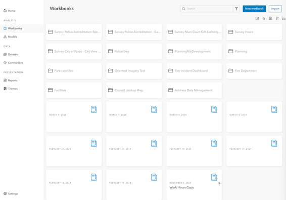

Looking at workbooks under analysis or just being on the home tab, I see all the blank ones.

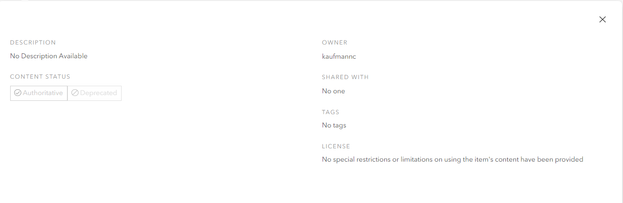

Trying to access them loads a blank page for 1 sec and then returns me to the page I was just on. In the above image. Hitting information provides nothing except my name. and clicking import gives me the error I mention in my lost reply.

  1. Check if any past updates are failing on the scheduled report. (use the screenshot I shared in the last comment)

1. Past updates only go back 30 hours (scheduled for hourly reports) of which none have failed so far.

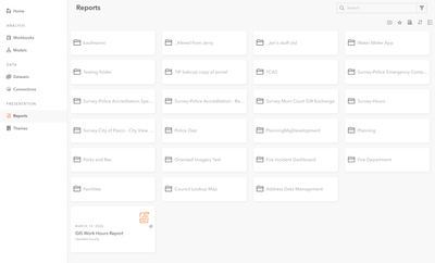

2. There are no blank reports in the report tab. These blanks only exist on the workbooks and home tabs.
Yes, I know. There will never be multiple reports created in that tab. Think of the Report as a workbook with just a single page. If it fails in the update process, it will leave a workbook in the workbook tab, not a report. In Question 2, I ask you to open the report and check if any of your analysis has errors and not just the reports tab.
