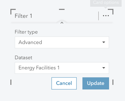

The time filter is desined to create filter a date range. What you need is a an advanced filter operation.
You can use Advanced filter on Dataset, Cards or with Filter widget to create something like DATEDIF(Start_Date ,DATEVALUE("MM-DD-YYYY"), "D") < 0 AND DATEDIF(End_date,DATEVALUE("MM-DD-YYYY"), "D") > 0 to get the records that you want.
Also, the filter widget (formerly predefined filter) is desined to work on a single dataset and downstream cards created from them. You will need to create one for each dataset.

Will the Advance filter inside filter widget work for you? Or do you need your viewers to change the advanced filter? Unfortunatly that is not possble and by design.
