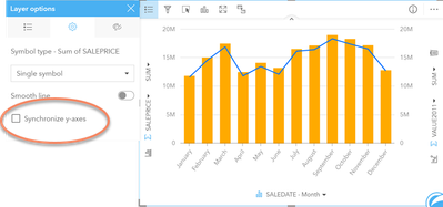

There is a strong need for a change to the combo chart (or for a new chart type). It need to plot the different columns or column and line on a shared y-axis. This need to be by default or by the user choosing to do so. Today, the combo chart plots them on different y-axis, where each y-axis is adapted to the maximum value of the field in question.

Status changed to: Implemented
LindaBeale
Thanks for your post.
Insights now allows the axis to be the same or different.  The combochart can now be used to compare relative difference or actual differences.  This was released with version 2020.3 (September 2020)
