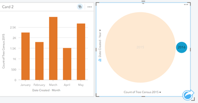

Note that the cross filter Akshay mentions allows you to take the functionality further.
For like-for-like functionality with what you mention from Dashboards all you need do is select a date-time component such as Month from the data pane, and drag that to a bar or column chart.
