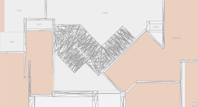

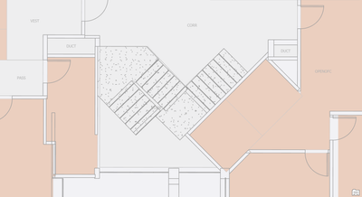

    • After appending the details layer, the lines in the online map were distorted. I’ve attached 2 screenshots comparing the details layer in the offline map versus after appending it to the online map.

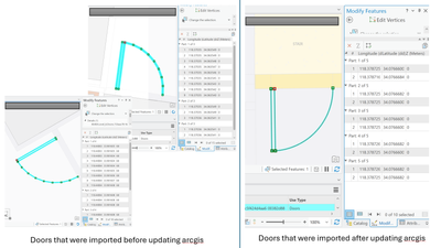

    • Doors shaped with arcs were not appended at all. The Append tool displayed warnings for these elements. I noticed that before the ArcGIS update, arc-shaped doors were represented using multiple vertices forming an arc. After the update, they were represented as actual arc geometry (see attached screenshot).

Details before appending to online layer
Details after appending to online layer

I have had the same issues in Pro 3.4.2.    For the append problem, it helped to remove and re-add the layers involved in the append process. But the curves in the details layer still don't come in exactly right.  I opened a case (Esri Case #03840276 - User has issues with the Curved line created from the ArcGIS Indoors in ArcGIS Online), and after testing, ESRI logged BUG-000175330.
