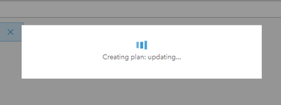

I've been working through the documentation to try and set up the Indoor Space Planner solution.  It's worked up to the point of creating the Space Planner app but having created the Space Planner app the next step is to create a 'Plan', but this step always fails with the following error:
I can't find any information on why it's failing.  The 'Plan' creation takes very little information (basically just a title) so I can't figure out why it's failing.  Presumably something is wrong with my data/map/Space Planner app but I'm at a loss to know where to look as I've followed the instructions to the letter.
Has anyone else experienced this?  Does anyone know where I can look to find out what the actual problem is?

I think I figured this one one out (well a colleague of mine did, but I'll take the credit...).  It seems that the map that you publish to use in Space Planner must be in WGS84 Web Mercator (EPSG:3857).  The documentation is vague:
13. Ensure that the map has a coordinate system set for Current XY, such as WGS 1984 Web Mercator (Auxiliary Sphere).
The above quote taken from bullet point 13 on this page: https://doc.arcgis.com/en/indoors/space-planner/arcgis-online-prepare-a-map-for-indoor-space-planner...
This feels like a bug in either Pro/Indoors or at least with the documentation.  Logging here in case anyone else hits the same problem so you don't spend hours trying to figure it out.

I should add, it doesn't error straight away, it seems to go through the steps and the progress message says:
Creating plan: exporting...
Creating plan: publishing...
Creating plan: updating...
And at that point the error message appears, so it feels like it's almost working but not quite.
