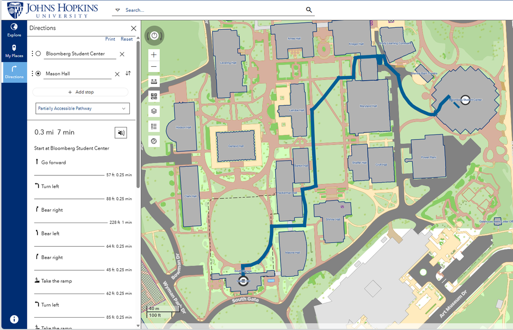

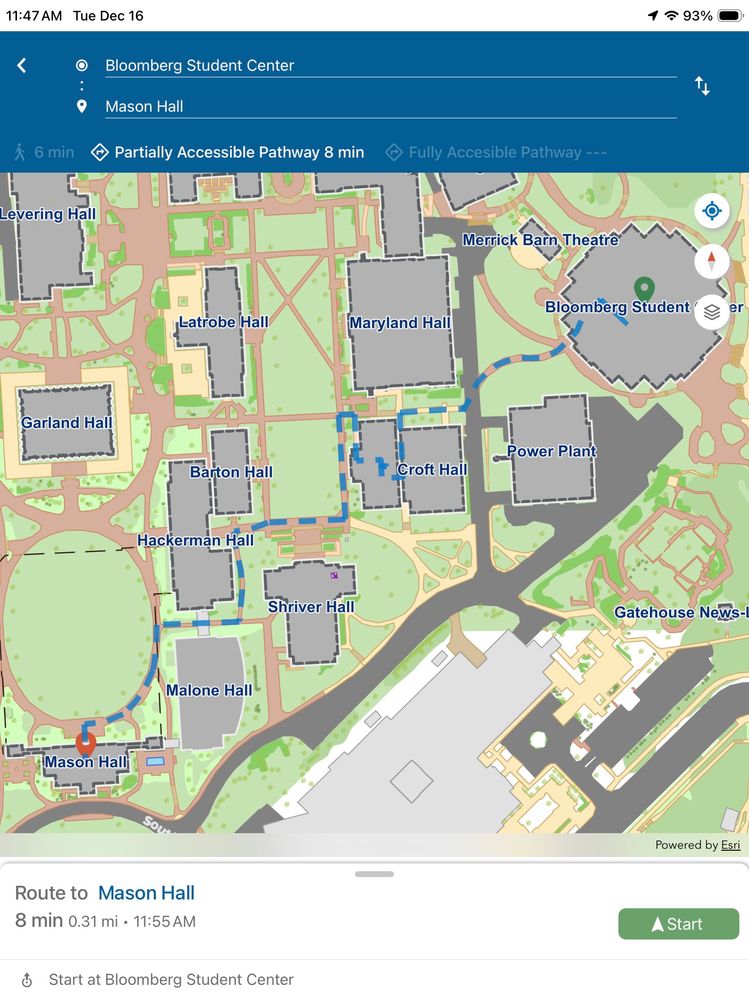

Generating a route with the same origin, destination, and network in a desktop Indoors viewer and the Mobile (Classic) app can give different results.
Is there any particular reason for this, and is there any way to ensure both give the same route?

The network dataset included in the mobile map are the same as the one used in the network service. Both apps use the same barrier service. I've since updated the network used in both, but the routes still differ.
Mobile:
Desktop:
