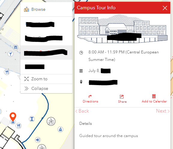

Hi,
We would like to add some attributes (e.g. a URL for further information) to our events. The pop up in the WebMap looks as expected, but when viewing it in the Indoors Web Viewer and Mobile App, these fields are not visible and it looks like that these apps ignore customised pop ups completely.
Is there a way to make custom attributes visible?
Info panel Web App:

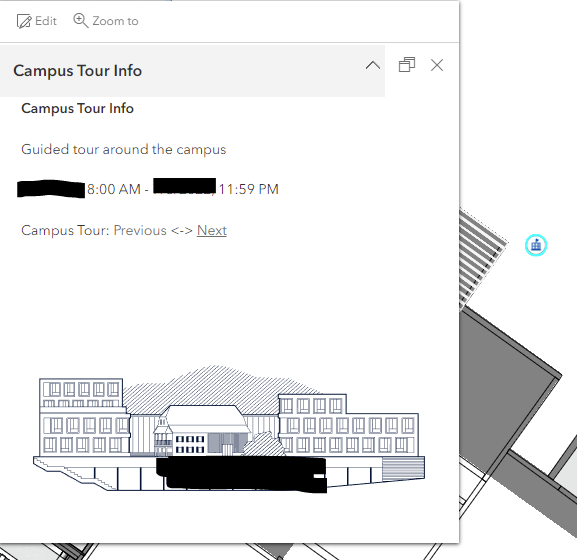

Custom pop-up (where "Previous" and "Next" lead to other events on the map)
My workaround for now is to use a POI layer, which allows custom fields and shows them in the info Panel, but it would be great to be able to add additional fields for the events.
edit: The workaround only works half, the url-Fields are not "active" links in the mobile app... So basically a showstopper, because this "tour" from one POI to the next is primarily a mobile thing. Any ideas how to make this work?
