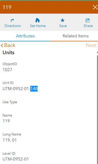

At our institution, other data associated with a space (examples: inventory, HR, space usage, occupany) uses a unique pre-defined format of site-building-floor-room. Using the CAD template, is it possible to specify this in upload.
Using the data from this photo, I would like to replace 148 with 119.
Thanks
HBWiese
We use custom IDs for the entire Indoors data model - site, facility, level, and unit. So yes, you should be able to customize that part of your Unit ID.  Of course, if you have anything in the model associated/related to that Unit, it will need to be updated as well.

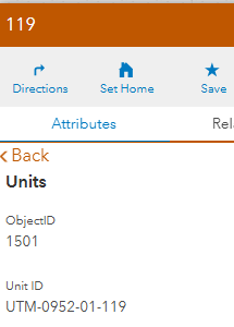

We were able successfully incorporate the room number into the unit ID as shown below
The fix is to ensure you're mapping the room number CAD layer to the unit ID target field (originally we just had name):
SOURCE_ANNOTATIONTARGET_FEATURE_CLASSTARGET_FIELD_NAME
a-flor-rnumUNITSUNIT_ID
a-flor-rnumUNITSNAME
