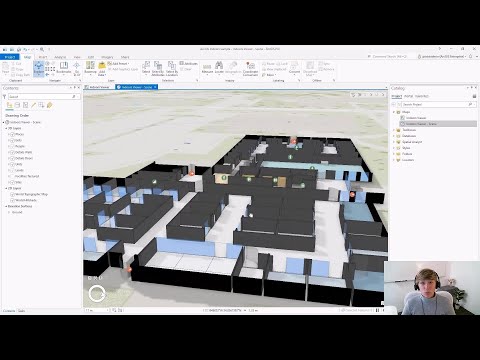

Video of floor-aware widget
https://www.youtube.com/watch?v=u7_FSg4sAVQ
