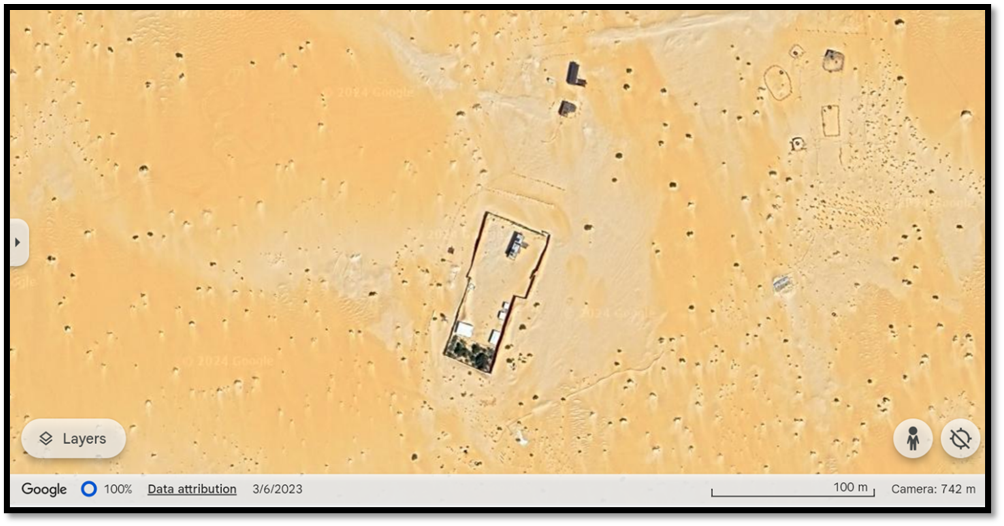

Challenge no.2: I am trying train a model that detects the below objects, is it possible to train one model able to detect the below objects efficiently?

Answer to "Challenge no 2" -- yea.. because I can detect it with my naked eye.. as long as enough training data you can train a model to detect that (and, similar objects) . Quality of models depends on the training data.. and some other techniques.. I am sharing two my blogs on effectively creating and using training data for object detection: Tips for labeling images for object detection models (esri.com) and Tips for training data preparation for object detection models (esri.com)
