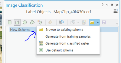

How do I create a schema that I can load into the Training Samples Manager and Label Objects for Deep Learning Tool??
906
02-02-2025 09:03 AM
Labels (2)
ScarletMaguire
I need to create samples in both Training Samples Manager and the Label Objects for Deep Learning tool. When I use both of these tools, I have the option to load in a schema with the "Browse To Existing Schema" option.So how exactly do I go about  creating the schema that I need to browse to?
I will be creating a lot of individual sample sets/deep learning objects in both of these tools- but I need all of these sample sets to follow the same schema!
PavanYadav
@ScarletMaguire please see the "Create a schema" section at: https://pro.arcgis.com/en/pro-app/3.3/help/analysis/image-analyst/create-and-manage-labels.htm
You can save the schema on your disk.
When you need to reuse it, you can use the the browse option
